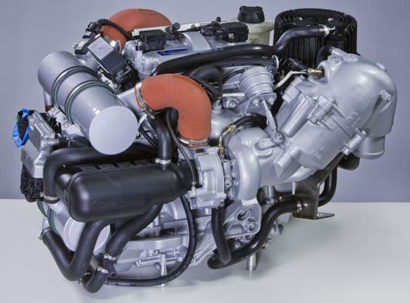

here are 2 new engines to try for the smaller inboard jet boats.
first is a suzuki 102 hp inline 4 cylinder set up for marine use
2nd is the new weber 850 MPE turbo that is rated at 160 hp
we will be getting 1 of the webers very soon for high altitude testing here in montana

do you have more information about Suzuki

You can link to the Internet at this motor Suzuki ?
S_Boroda
Сообщений: 381
Re: 2 new engines to try
Сообщение S_Boroda » 09 окт 2012, 13:49
In Russia we have a saying - Said "A" and "B" say!
suzuki 102 hp inline 4 cylinder setup for marine use -This engine from the car?
What model of the engine?
information engine code?
Who did the conversion engine for marine use?
What is the cost of these devices?
P.S. Photo Suzuki of very small and do not unfold to its normal size.
Is there a better quality photos?
And from different perspectives?

Там же написана модель мотора на фото G13. Разновидность G13BB судя по всему.

Не думаю, потому что самый мощный из этой серии имел 88 лошадок.
P.S. Устриц ел, т.к. был Сузуки Джими 1,6 с автоматом. Вот код двжка не помню.

http://en.wikipedia.org/wiki/Suzuki_G_engine
Да тогда это G13B она 100 лошадей как раз.

http://hisonjetski.en.alibaba.com/produ ... _Boat.html
кажись отсюда..ноги растут.

these suzuki engines are the G13BB
RPM HP
4500 71
5000 79
5500 87
6000 94
6500 102
7000 99
they are complete for marine use here in the USA by an engine company
the price for complete turn key engine ready to install is $ 4400.oo
which is about $1500 cheaper then the weber 750MPE 110 hp turbo
