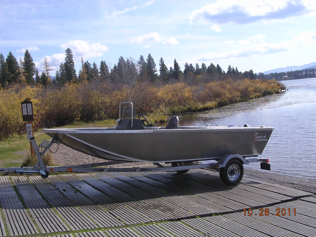

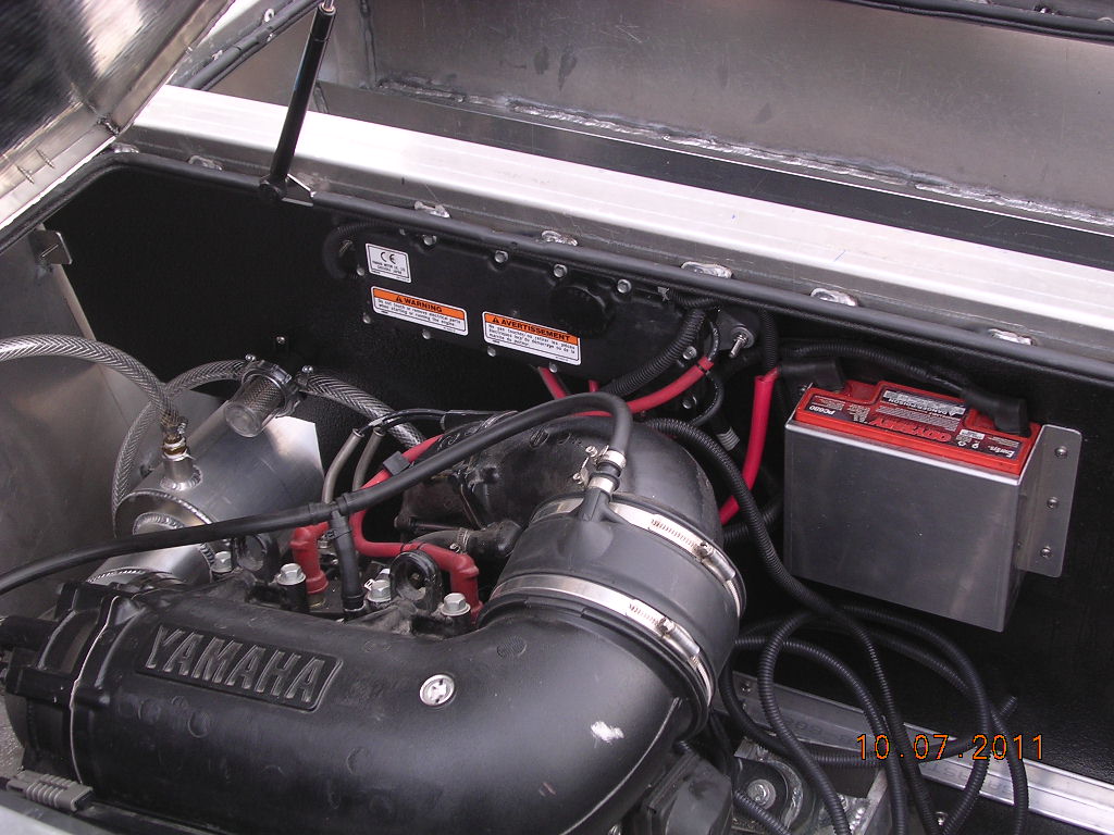

Сообщение bottomdweller » 14 дек 2011, 02:15
sure here is some more info on the boat in the pic
engine is a 85hp yamaha 2 cylinder 2 stroke
boat is 16' long
wt is 1150 lbs.
top speed with new super thick impeller is 38 miles per hour on the river or around 65-66 km/h
jet pump is aquajet 6" jet pump
i did not build the boat hull i just made it an inboard jet my installing jet pump then the engine
also built the oil tank to hold the oil for the oil injection that this engine has and the tank holds 2 gallons of oil so you can go for a few trips before having to had oil. it has 3 seats and 2 more fush mount seat bases so you can move the seats around for fishing. it has a gas pedal and single lever control for rev.
anchor light and bow nav light bilge blower fan and bilge pump. horn,swim deck,windshield. and fast steering that is 135 deg. from full left to full right.
also has the full 16 cubic feet of foam to meet the flotation for the coat guard .it also has oar locks so when you are fishing and drifting down the river you can keep the fisherman pointed in the right way.

Сообщение дядя Вася » 14 дек 2011, 07:51
Hi Bill
Than you very much for answer.
You planning make" MJB"jet-pump.
What don't like in Aqvajet?
Сообщение дядя Вася » 14 дек 2011, 20:00
"boat is 16' long"
width?(breadth)
